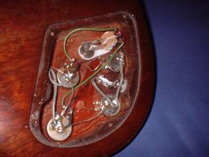

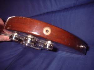

In Case Youre still interested I just took these photos of my 1980 SG
Richard
PostPosted: Wed Apr 04, 2007 3:42 am
Posts: 2711
Location: Victoria, BC
Last Name: Abercrombie
[QUOTE=Cachalote] In Case Youre still interested I just took these photos of my 1980 SG
Was the side jack done later?
Usually the recesses have finish sprayed in them (routing and drilling are done before sanding and finish).
It also looks like you have the '5 holes in the face' like a regular SG there. I can't tell from the pic if there was a re-wire done at some point.
Interesting. Thanks!

Hey those pictures are terrific! Thanks for taking the time to post them. I'd never heard of or seen an SG like this until I got the call from the customer. Now I've got a good idea of what I'm dealing with and lots to go on. Thanks guys
